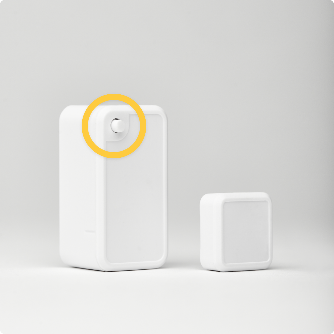

On the back of the Door Sensor, you will find the tamper button. The tamper button has two functions:
  1. Maintenance mode
    Tamper detection button on the top left corner of the door sensor
    Pressing the tamper button allows you to put the Door Sensor into maintenance mode and connect it to the Nuki App.
  2. Tamper detection
    Assuming the installation has been done correctly, the tamper button of the Door Sensor will be permanently pressed when mounted. If the Door Sensor or mounting plate becomes loose or is removed, the tamper button will be released. This will then trigger the tamper detection and you will be notified through the Nuki App. Even if the tamper button becomes loose just a little bit, this will still activate the tamper detection.
