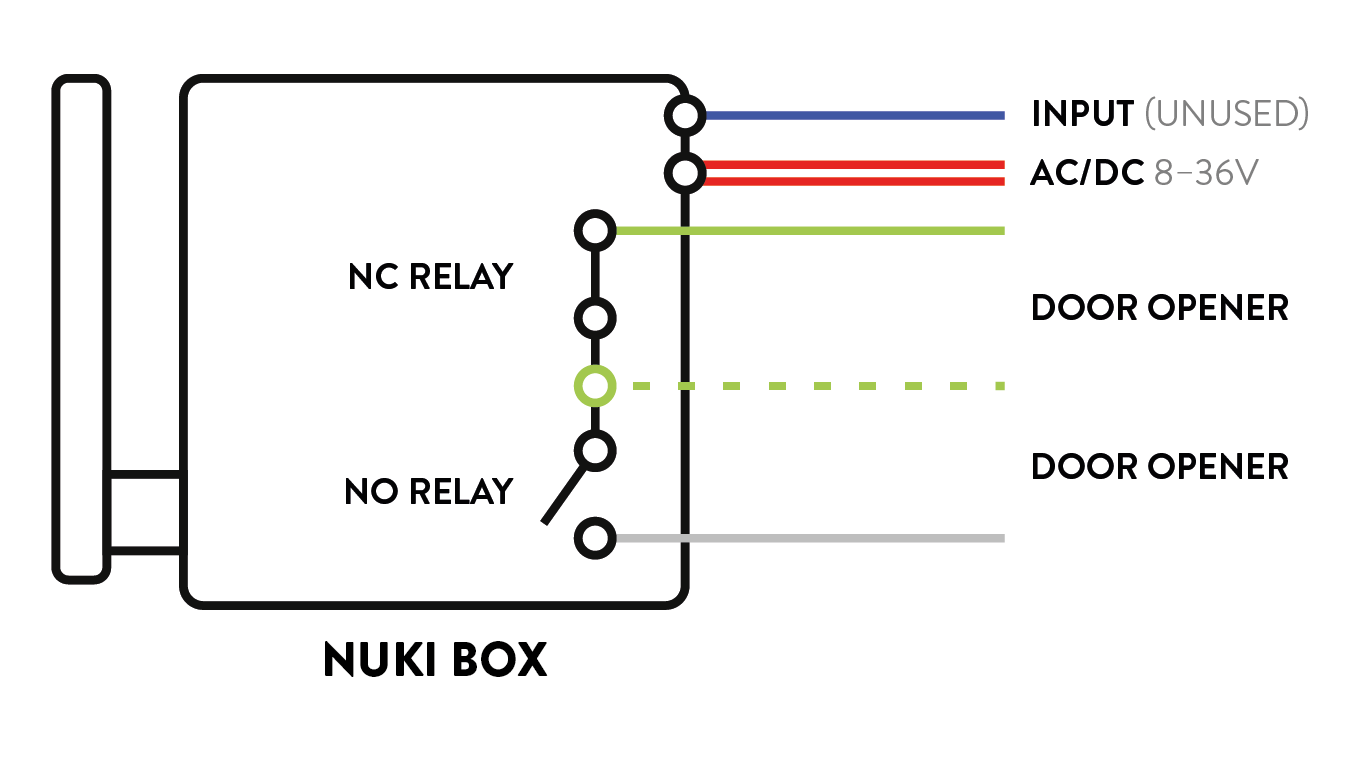

- Depending on the locking system you have, connect either the NO-contact (Green-White and White) or the NC-contact (Green-White and Green) of the Nuki Box with the opening mechanism of the door.
- The Nuki Box has to be connected to power with the help of a suiting power supply unit (8-36 Volts AC/DC).
- As soon as the Nuki Box is connected correctly, the booting process of the device will start. The LED flashes red in intervals of one second. This process takes about 30 seconds.
- As soon as the Nuki Box is connected to the Nuki servers the LED will light up green. This may take a few minutes depending on the GSM signal quality. As soon as the LED lights up green, proceed with the setup of your Nuki Box.
PIN out and schematics
Cable Pin out:
Red: Power Supply (8-36V AC/DC)
Green-White and White: Relay, Normally Open contact (NO)
Green-White and Green: Relay, Normally Closed contact (NC)
Blue: Input (currently not used)
