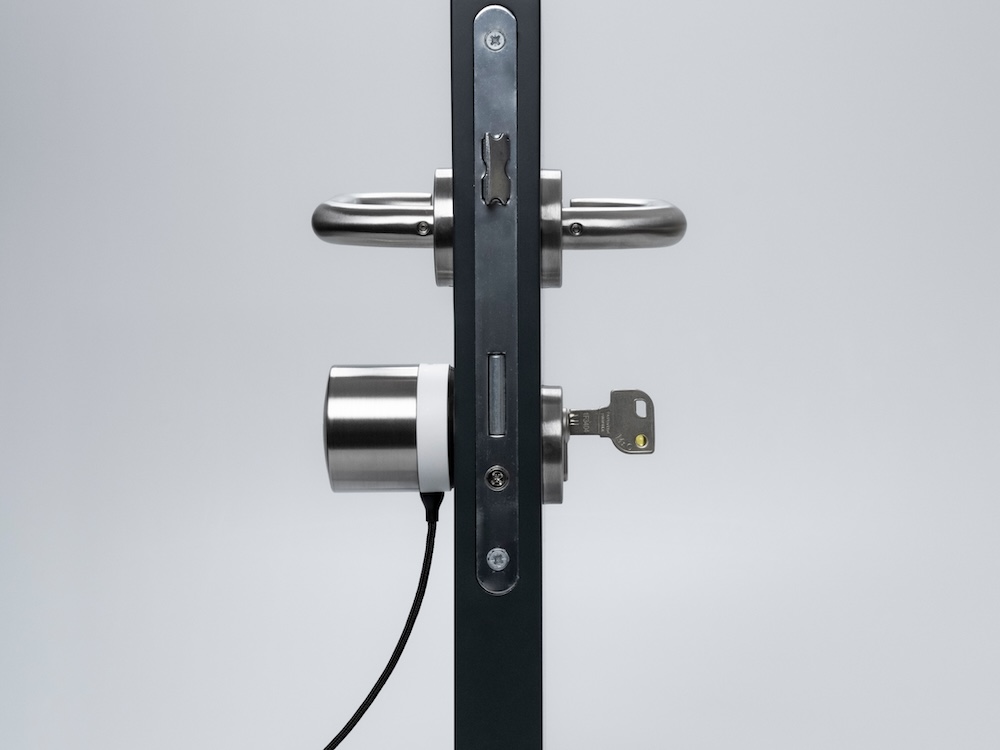

Charging on the door
Your Smart Lock performs lock actions in this charging mode. Don't worry: The part of the Smart Lock where you plug in the magnetic charging cable doesn't rotate during locking. Nuki recommends this charging mode as you can still lock your door while you are charging.
Do you want to activate the “Charging on the door” mode? Simply plug in your charging cable. Be careful not to block the door with the cable. This charging mode is activated automatically.

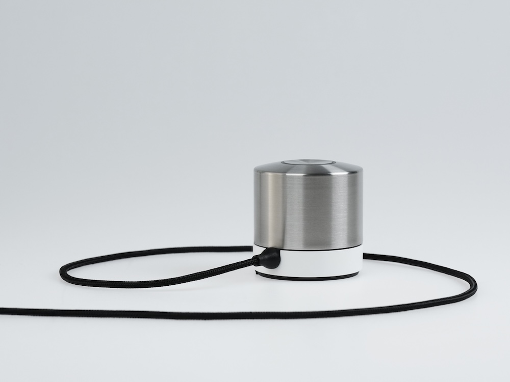

Charging off the door
If you want to charge your Smart Lock unmounted from the door, we recommend the “Charging off the door” mode. It rejects automatic locking actions in this mode. These actions include:
  • Scheduling
  • Night Mode
  • Auto Unlock
  • Auto Lock
So if a family member approaches your home or the night mode triggers a locking action, your device will not move. After all, you are charging it unmounted from the door. It is best to use this mode during the night, as this is when the fewest people use your door.
Do you want to activate the “Charging off the door” mode? Plug in your charging cable and press the button in the next 15 seconds (while the Smart Lock is flashing red).
Have you activated the “Charging off the door” mode by mistake? Simply unplug the charging cable and plug it back on without pressing the button afterwards. You can still perform locking actions in the “Charging off the door” mode via the app or the button. Only automatic locking actions are rejected. So if the Smart Lock is mounted on the door, you can still operate it.
