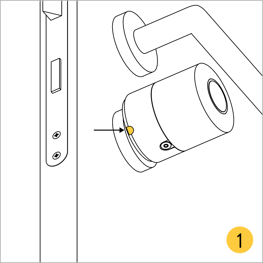

- There is a small button located on the bottom-left of the Smart Lock.

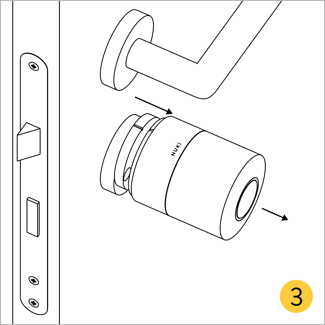

- Press this button while turning the Smart Lock to the left.
- Now, you can take the Smart Lock from the mounting plate.
