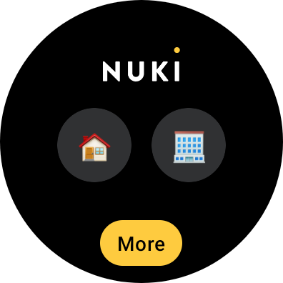

Support of the Wear OS Tiles
In the list of available tiles on your watch you will now also find a Nuki Tile. Select the Nuki Tile and add it to the carousel on your watch.
The Nuki Tile shows buttons for up to three devices and a ”More” button.
- Clicking on one of the buttons opens the Wear OS app and takes you directly to the selected device.
- Clicking the ”More” button opens the Wear OS app without going to a specific device.
This way the Nuki Tile provides you easy and fast access to your Nuki devices.
