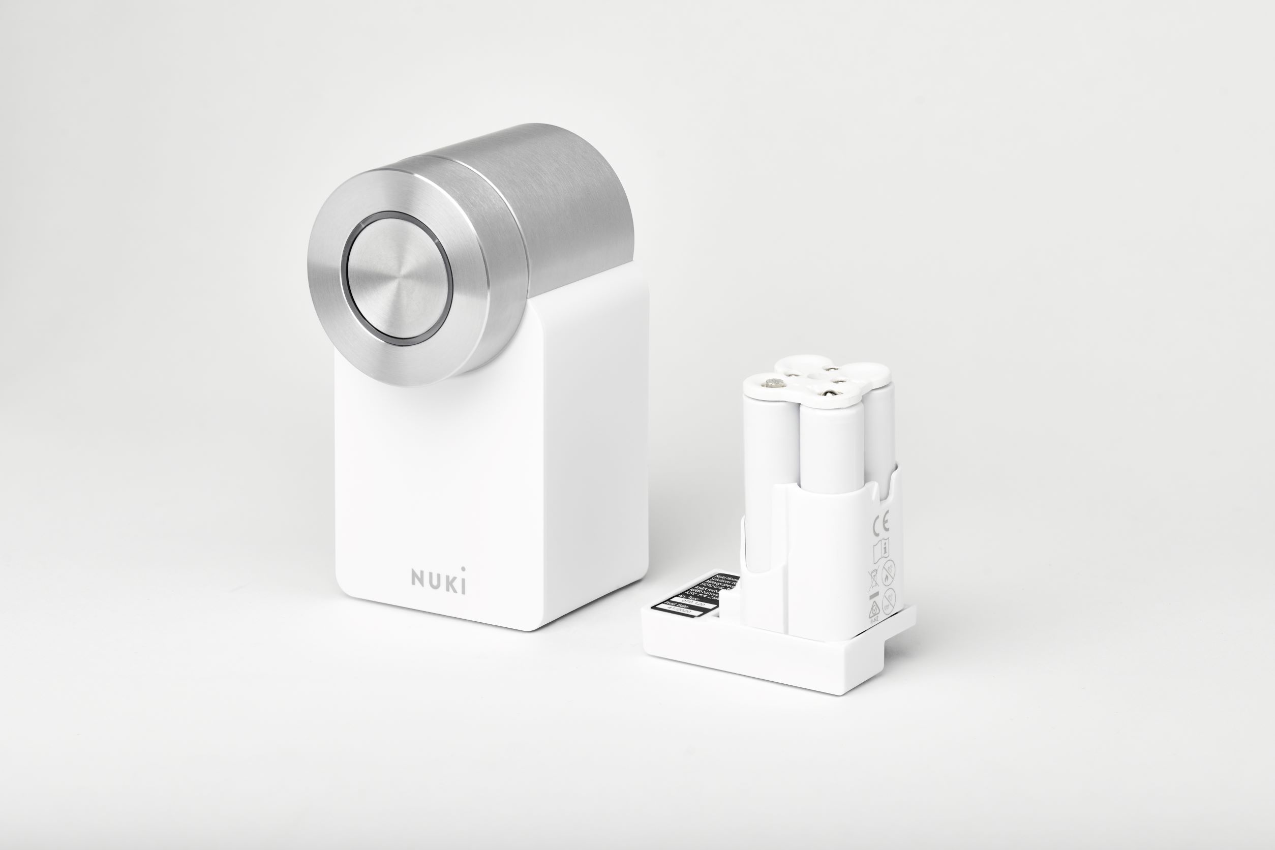

A Smart Lock and the Power Pack that is a little smaller

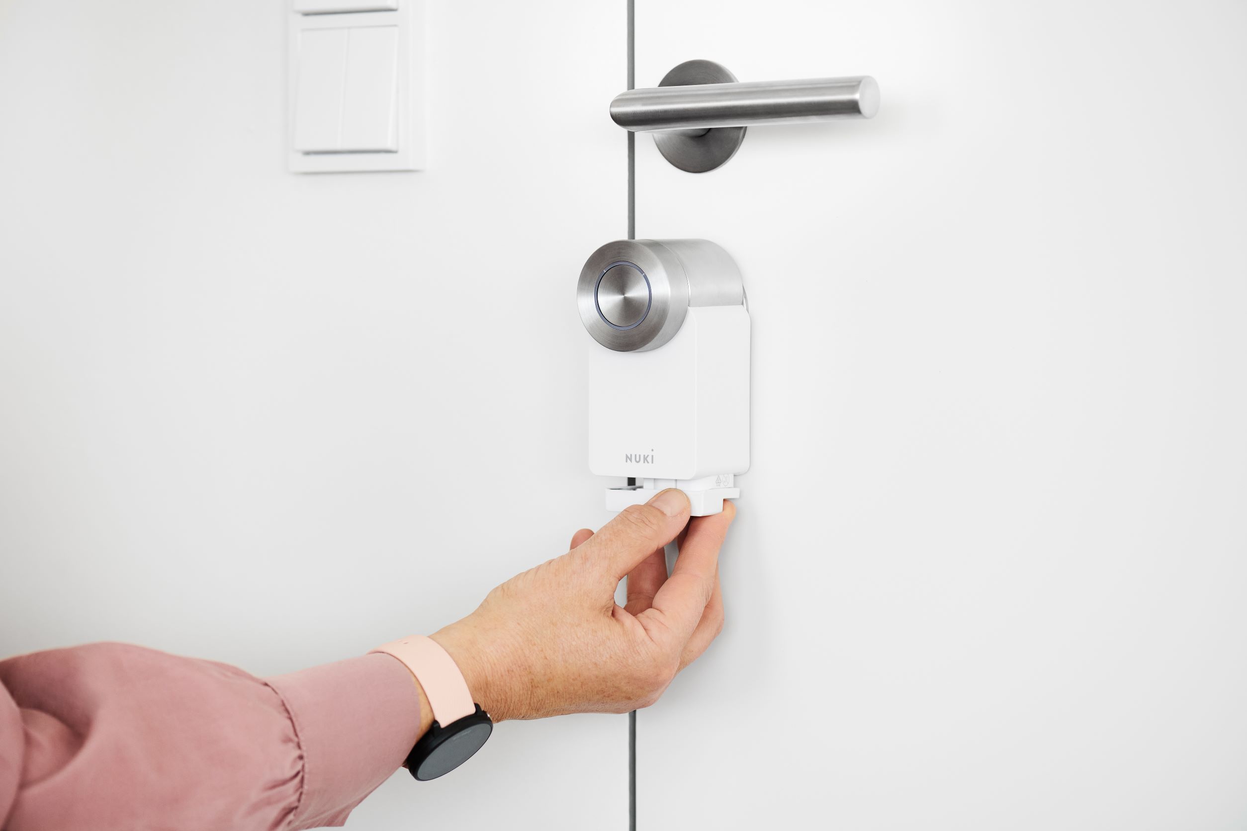

The Smart Lock is mounted on the door. The power pack can be inserted at the bottom

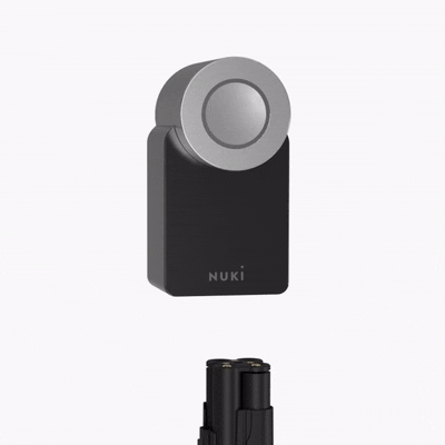

Insert the Nuki Power Pack through the bottom of the Smart Lock
