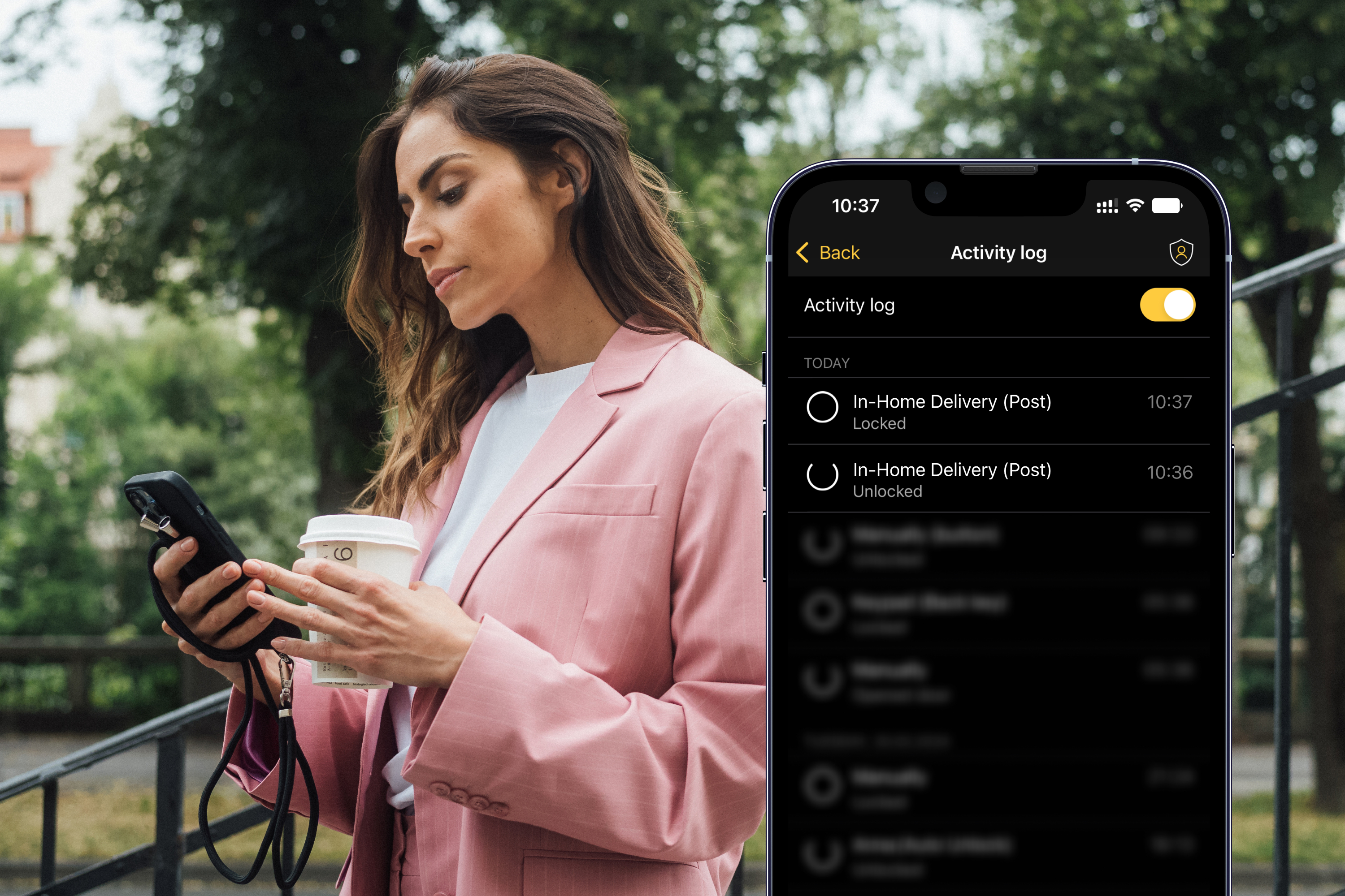

The activity log tracks the lock actions by Austrian post. This example shows a woman looking in her activity log. She can see that the user called In-Home Delivery (Post) unlocked her door at 10:36 and locked it again at 10:37. So she can be sure that her parcel got delivered and that her door got savely locked again.
