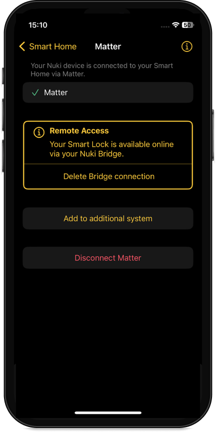

Delete Bridge connection
Switching from Bridge to Thread
If your Smart Lock is paired to a Bridge, you first need to disconnect the Bridge connection. To do so, open the Matter settings in the Nuki App and tap „Delete Bridge connection”.
After deleting the Bridge connection, the Remote Access via Thread is automatically established.

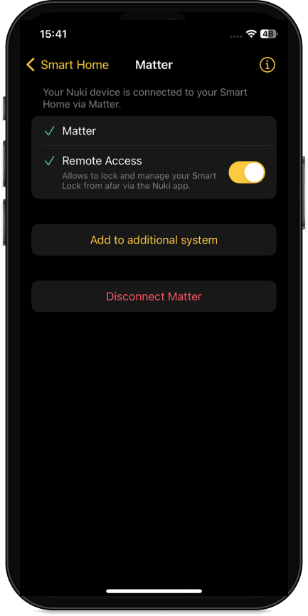

Remote Access via Thread enabled

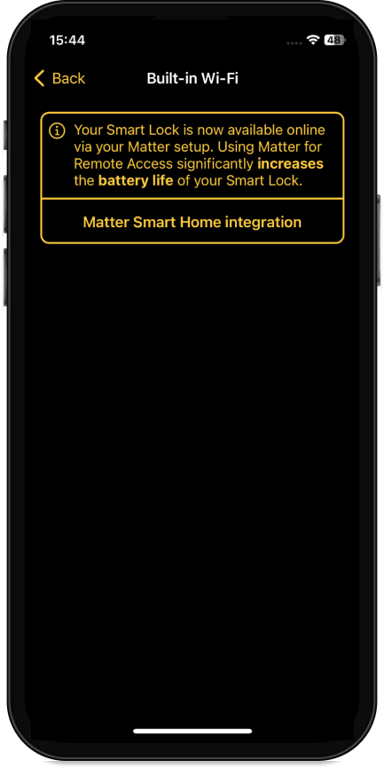

Switching from Thread to Wi-Fi module
If you want to change the remote access connection from Thread to Wi-Fi, simply disable the option ”Remote Access” in the Matter setting. After that, go to ”Features & Configuration” > ”Built-in Wi-Fi” in the Nuki App and ensure that he Wi-Fi is correctly set up.
Switching from Thread to Bridge
If you want to change the remote access connection from Thread to the Bridge, simply pair the Bridge using the Nuki App. This will automatically turn off Remote Access via Thread.
