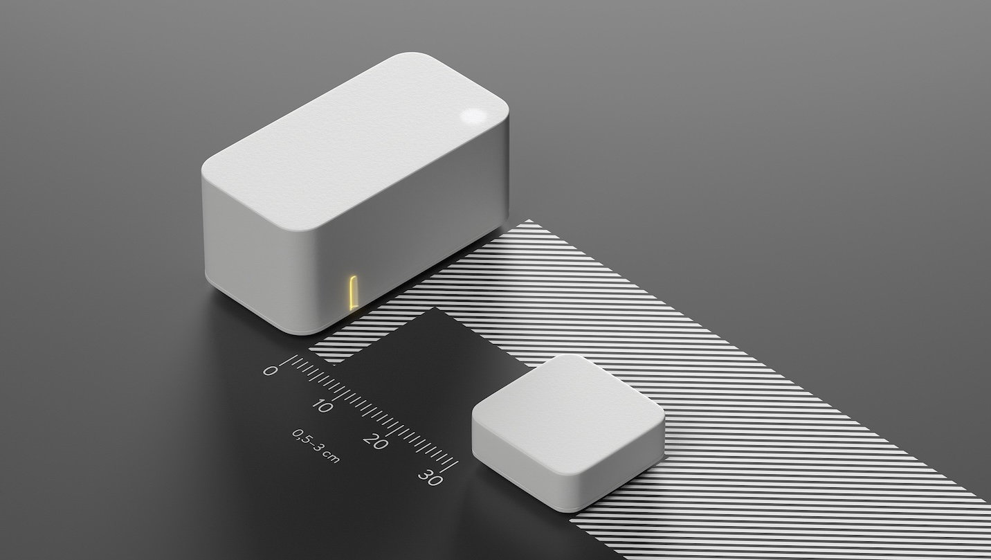

Installation notes:
  • Pay attention to the mark (notch) on the sensor. It must face the magnet.
  • Also, pay attention to the bottom edges: The edge under the sensor mark must be at the same height as the bottom edge of the magnet.
  • The distance between the Door Sensor and the magnet should always be between 0.5 cm and 3 cm.
  • Examples for installing the Door Sensor.
illustrating Installation notes above
