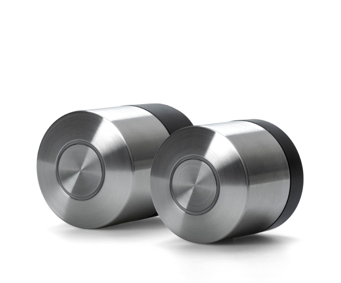

Smart Lock Ultra or Pro batteries
Smart Lock Pro and Ultra with built-in batteries
Your Smart Lock Ultra or Pro has a built-in battery pack. Our many years of experience with Smart Locks have led us to choose these batteries for the best user experience. The batteries are permanently installed, so you don't have to service or replace them.

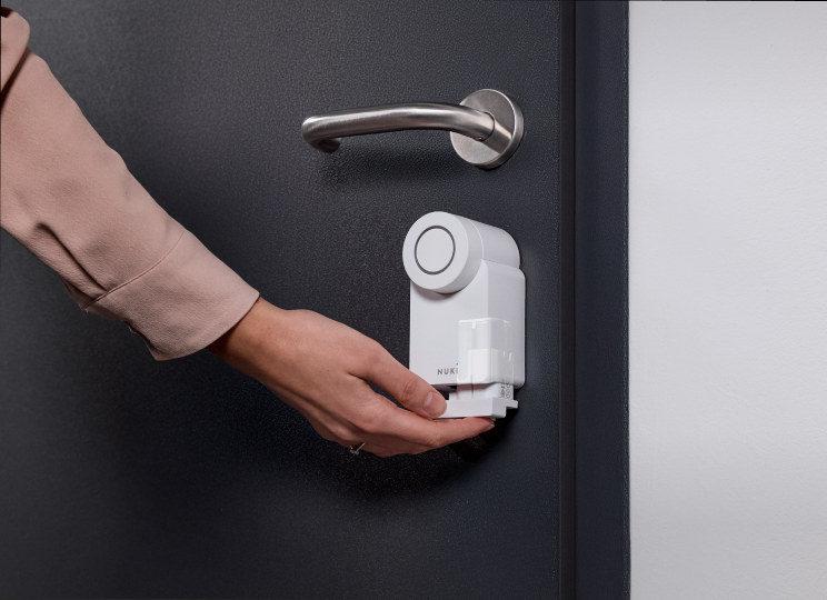

How to change the batteries of your Smart Lock Go and previous generations
To replace the batteries or unmount the Power Pack, proceed as follows:

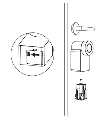

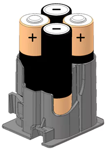

How to remove the battery compartment: push the lever and take it out                         battery compartment with 4 batteries
  1. The battery compartment is located on the bottom of the Smart Lock. To open it, press the small lever in the arrow direction and take the battery compartment out of the Smart Lock.
  2. Replace the batteries and insert the battery compartment back into the Smart Lock.
