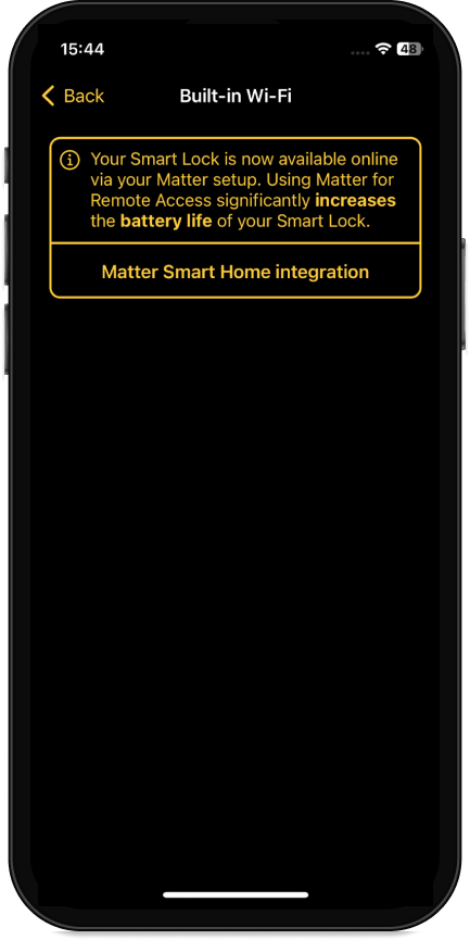

Switching from Wi-Fi module to Thread
If you have already activated the built-in Wi-Fi module, the Wi-Fi connection will be automatically deactivated, and Remote Access via Thread will be established.
If the Thread network does not support an internet connection or it is not available, your Smart Lock will continue to use the Wi-Fi connection.

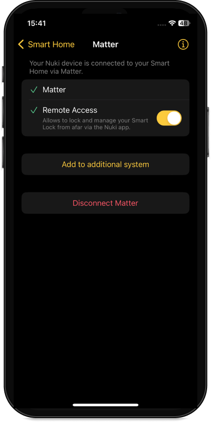

Remote Access via Thread enabled
Switching from Thread to Wi-Fi module
If you want to change the remote access connection from Thread to Wi-Fi, simply disable the option ”Remote Access” in the Matter setting. After that, go to ”Features & Configuration” > ”Built-in Wi-Fi” in the Nuki App and ensure that he Wi-Fi is correctly set up.
