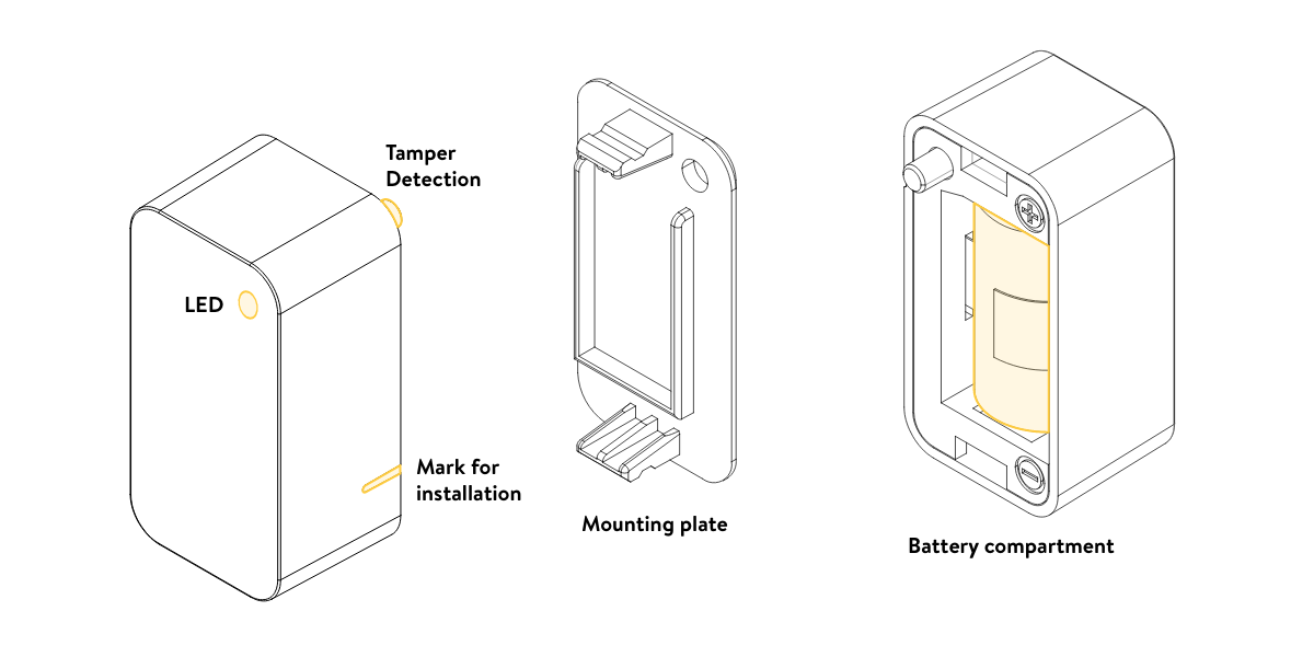

The Door Sensor operates on a 3.6V lithium battery (½ AA ER14250) with a lifespan of approximately 2 years. The Nuki App notifies you when the battery level drops to 20%.
Steps to replace batteries
The battery compartment is located on the back of the Door Sensor. It is closed by the back panel of the Door Sensor, which serves as a mounting plate.
To open the battery compartment, remove the Door Sensor from the mounting plate.
If your Door Sensor is already mounted, just hold it on both sides and pull the housing forward.
