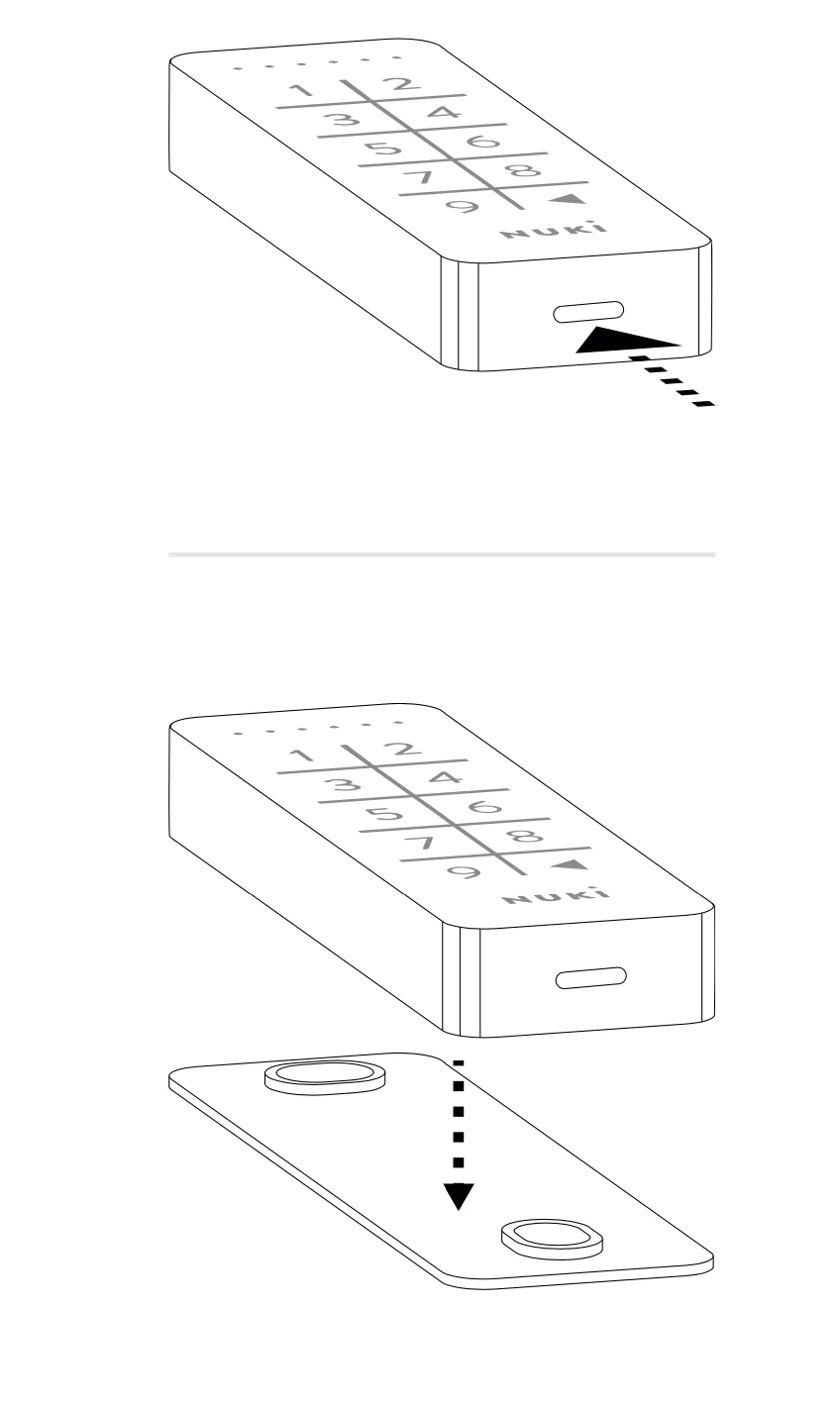

  1. Open the housing by detatching the mounting plate. Simply push the button at the bottom and remove the mounting plate. Now, you can see the batteries.
    If the batteries are not easy to remove, use a flat-head screwdriver to remove the batteries.
  2. Now insert two new CR2032 batteries (button cells) and close the case carefully.
Open the Housing of the Keypad 1 - detach the lower part from the upper one
