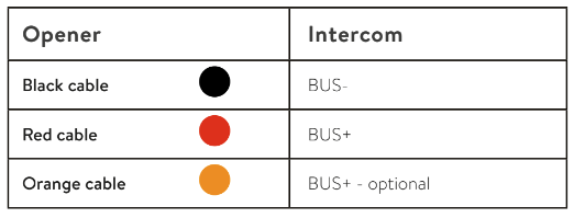

Basic wiring with digital systems
With the basic wiring, you can use all the features of the Nuki Opener. Only the ring suppression is not supported.
Please follow these instructions:
  1. Start from the original wiring before you have connected the Opener.
  2. Just connect the black wire of the Opener (in addition to the wire of the system) to position **b** (Bus-).
  3. Connect the red wire of the Opener (in addition to the wire of the system) to position **a** (Bus+).
  4. Please don't perform further changes. Do neither remove any wires or use the other wires of the Opener nor the extra connector block you received with your Opener.
  5. Now redo the configuration with the Nuki App.
Basic wiring setup digital Intercoms: Black cable = Bus minus, red cable = Bus plus, Orange cable = Bus plus (optional)
