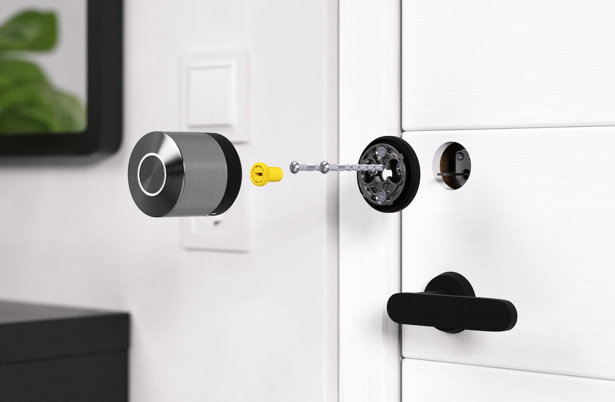

verview of mounting the Smart Lock Nordics: The mounting plate is fixed to the door with screws. Next, an adapter is placed on the mounting plate. The Smart Lock then goes on top of that.

4. Attach the mounting plate
The marking on the mounting plate shows you how to attach it. Make sure that the marking on the mounting plate is at the top.
Fix the mounting plate to the door using the screws you removed from your door earlier.
5. Place the adapter
Place the adapter on the tailpiece to connect it to the Smart Lock in the next step.
