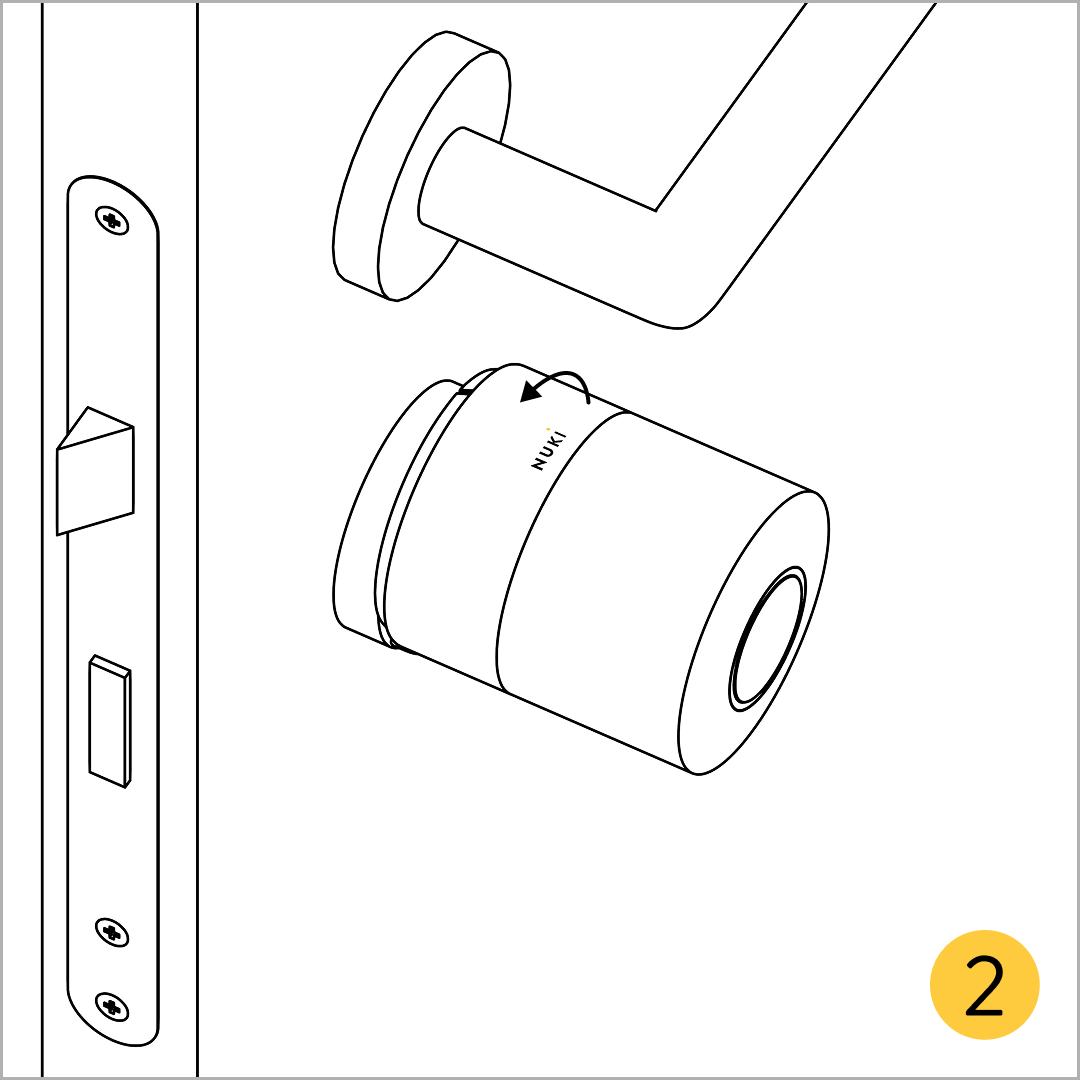

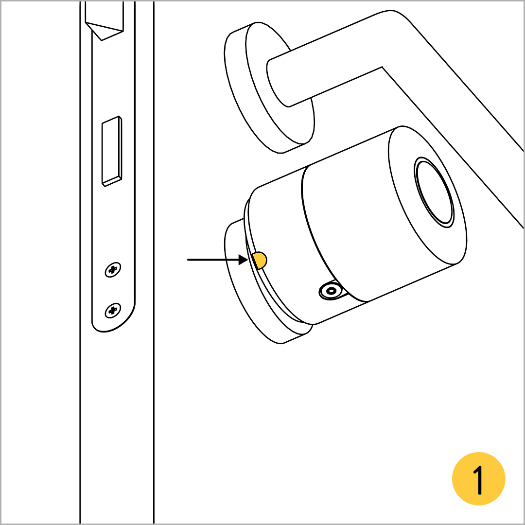

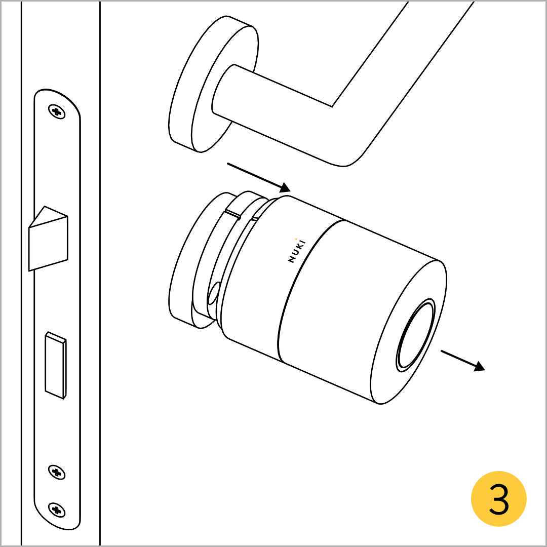

  1. There is a small button located on the bottom-left of the Smart Lock Ultra or Pro.
  2. Press this button while turning the Smart Lock to the left.
  3. Now, you can take the Smart Lock from the mounting plate.
Unmounting Smart Lock Ultra and Pro Step 1
Unmounting Smart Lock Ultra and Pro Step 2
Unmounting Smart Lock Ultra and Pro Step 3

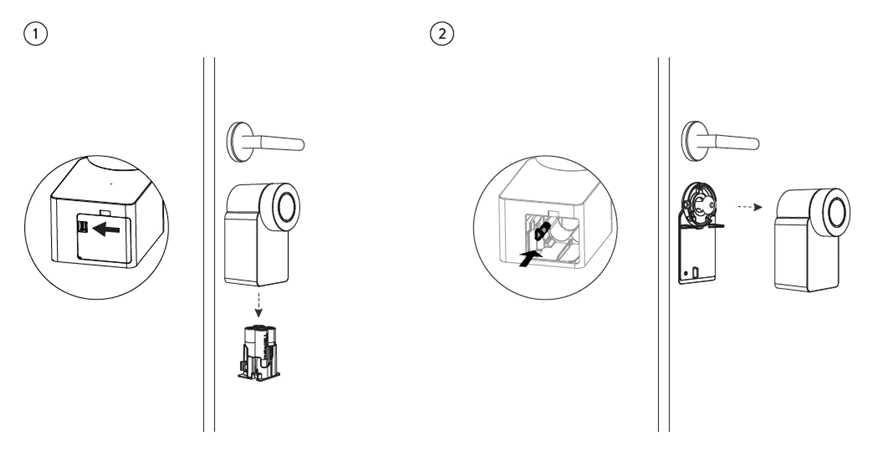

Uninstallation of the Smart Lock with removable batteries
  1. The battery compartment is located on the bottom of the Smart Lock. To open it, press the small lever in the arrow direction and remove the battery compartment from the Smart Lock.
  2. After you have removed the battery compartment, you will see a colored bolt. Press the colored bolt in the arrow direction to the inside. After the bolting is released, you can take the Smart Lock from the mounting plate.
Step for step demounting guide of the smart lock
