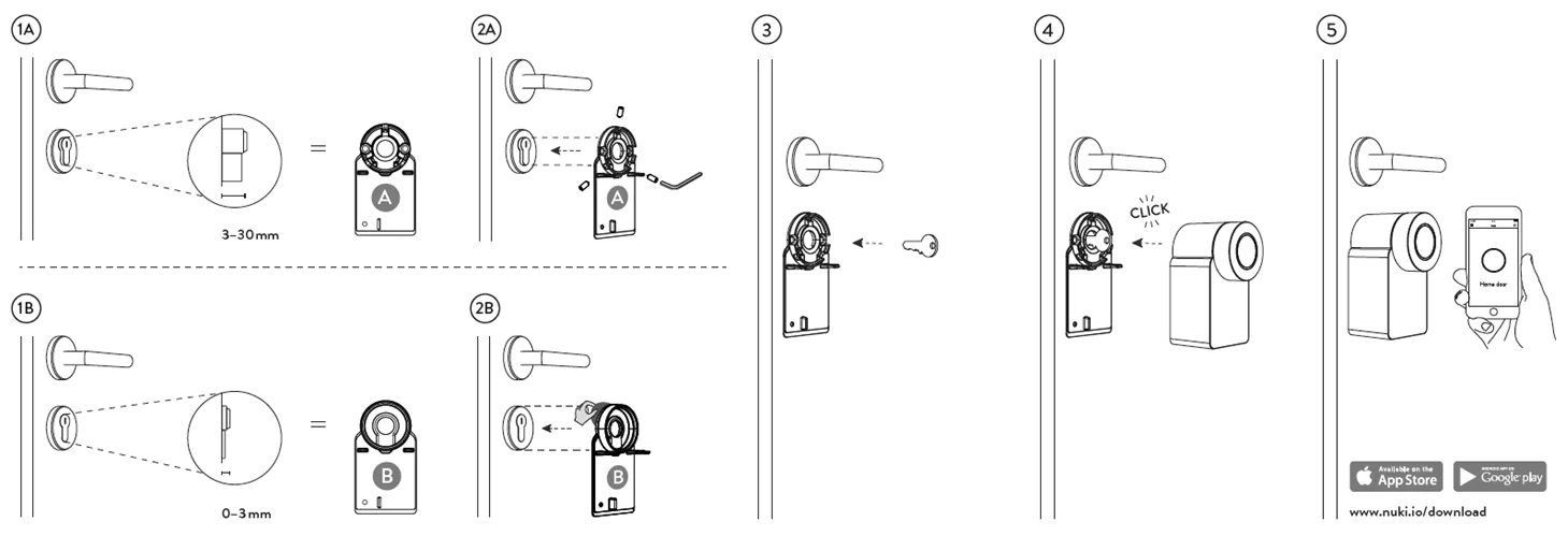

Installation with the clamp-on mounting plate (Version A)
Cylinder with at least 3mm overhang on the inside of the door: The Smart Lock is fixed to your cylinder using three screws.
  1. Take mounting plate A from the packaging
  2. Screw-fix the mounting plate to the cylinder with the supplied wrench
    Please fix the screws carefully and without great physical effort to avoid damaging the cylinder.
  3. Put your key into the lock
  4. Attach your Smart Lock to the mounting plate
  5. Download the Nuki App on your smartphone and set up your Smart Lock
Installation with the stick-on mounting plate (Version B)
Cylinder with less than 3mm overhang on the inside of the door: The Smart Lock is glued to your door with special adhesive pads.
  1. Take mounting plate B from the packaging
  2. Clean the surface where the stick-on plate will be placed. Peel off the protective backing and stick the mounting plate to your door
