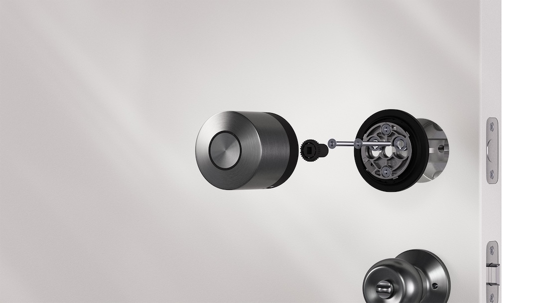

Overview of mounting the Smart Lock US: The mounting plate is fixed to the door with screws. Next, an adapter is placed on the mounting plate. The Smart Lock then goes on top of that.

5. Choose the fitting adapter
Three adapters are included in the delivery. Choose an adapter that fits your door's tailpiece. Place the adapter on the tailpiece to connect it to the Smart Lock in the next step.
6. Mount your Smart Lock
Make sure that the marking on the Smart Lock is at the top. Then, turn the Smart Lock to the right until it snaps into place. You hear a clicking sound when it snaps into place. Your Smart Lock is correctly positioned if the lettering "Nuki" is centered at the top.
