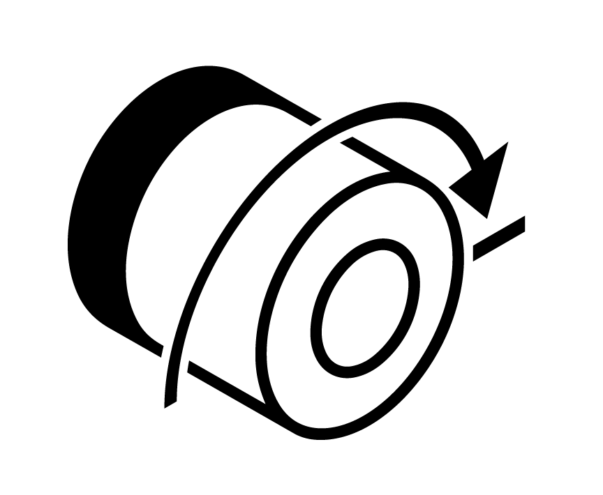

  2. Carefully turn the Smart Lock as if you were locking it with your key. Try turning it in both directions. Be careful not to use excessive force, as this could damage it.
