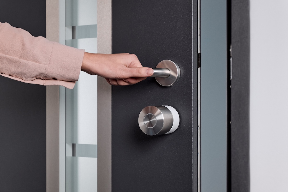

Press the Button to lock the Nuki device

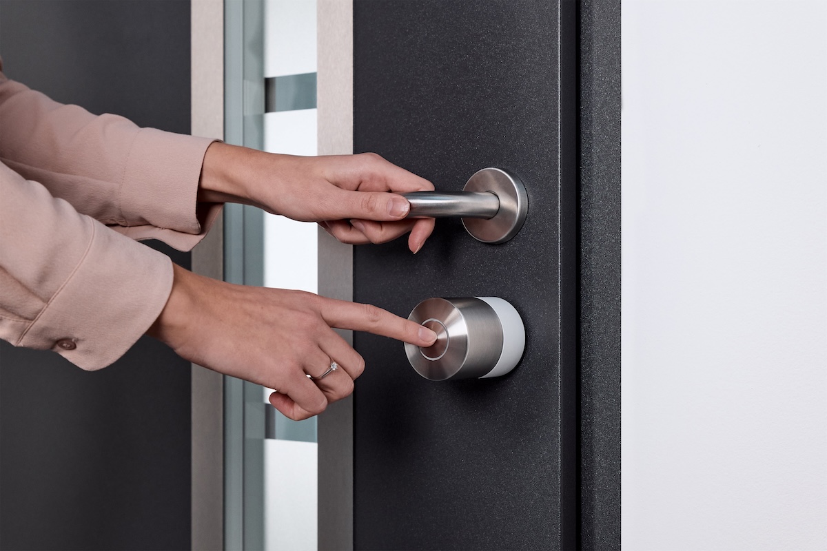

Turn the knob on the inside of your door to lock the door with Nuki

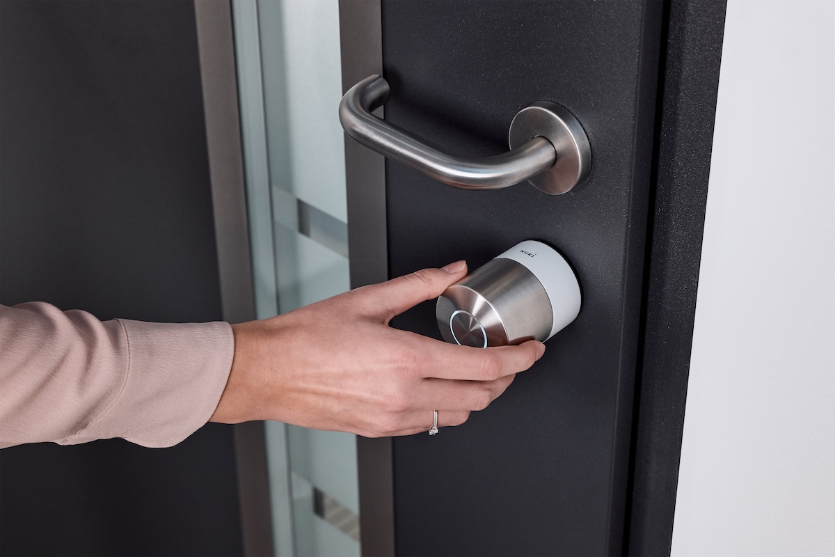

Smart Lock locks automatically with Lock n Go
