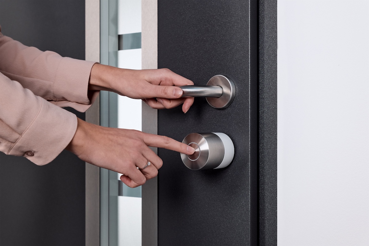

Press the Button to lock the Nuki device

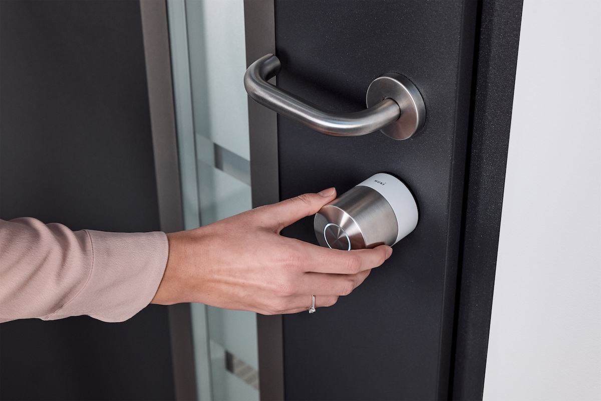

Turn the knob on the inside of your door to lock the door with Nuki
