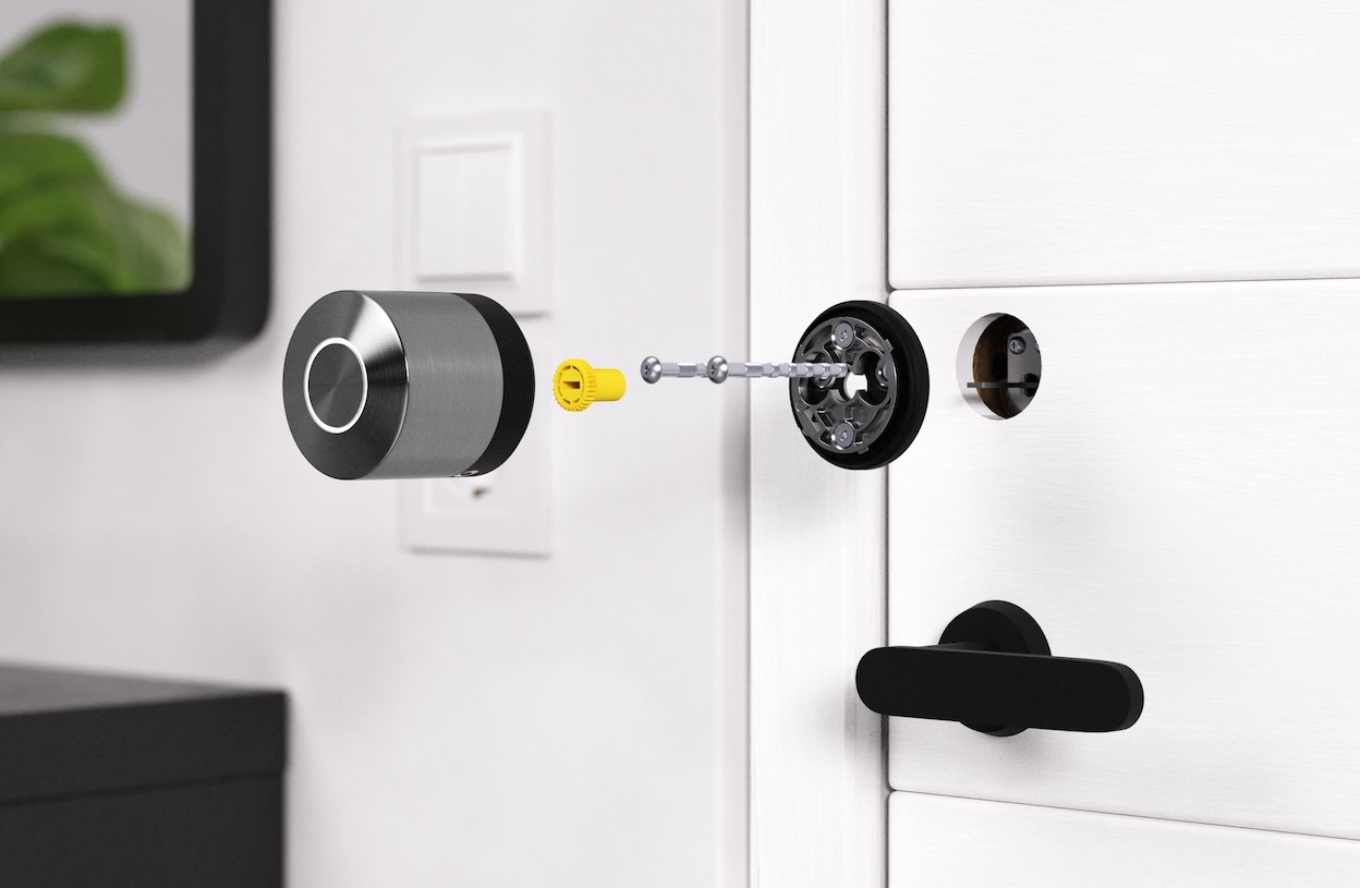

verview of mounting the Smart Lock Nordics: The mounting plate is fixed to the door with screws. Next, an adapter is placed on the mounting plate. The Smart Lock then goes on top of that.
